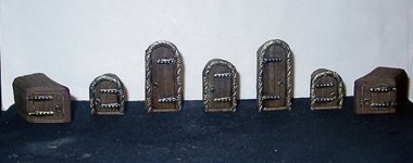

HA!! Hello Guillermo and all,More progress to report on my Wasa.I have built the bow door assemblies.This kit did not supply these two doors so I made my own.There were thirty parts per side.I have also shaped and affixed the decorative moldings hinges and handles.These moldings were much more difficult to shape than I thought that they were going to be.If I were to do them again,I would heat them to bend them.But with the help of my looping plyers,brass hammer and anvil,They are finished.Cheers Walter............ ¡¡AH!! Hola Guillermo y todos, Más progreso para hacer un informe en mi Wasa. He construido las asambleas de puerta de arco. Este equipo no suministró estas dos puertas entonces hice mi propio. Había treinta partes por lado. También he formado y he adjuntado los goznes de moldeados decorativos y mangos. Estos moldeados eran mucho más difíciles de formar que pensé que ellos iban a ser. Si yo debiera hacerlos otra vez, yo los calentaría para doblarlos. Pero con la ayuda de mi colocación plyers, el latón martilla y yunque, Ellos son terminados. Aclamaciones Walter :D

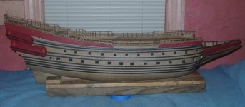

Hello Guillermo and all,It has been many months since my last post.Wasa progresses slowly.Decorations are comming soon!Im not happy with the lower stairs :( I will remove them and make my own.Not the proper shape.Cheers,Walter :P .........Hola Guillermo y todos, ha sido muchos meses desde mi último post.Wasa se avanza slowly.Decorations pronto! Messenger no contento con la parte inferior: las escaleras (I se eliminarán y hacer mi own.Not el buen shape.Cheers, Walter

hello Walter, I like your vasa is not anything wrong, although missing some sculptures between the two doors, the stairs looks good, a little wheathering on them will give them a realistic look, I hope to see you soon around here with the decorations placed on the vasa
Guillermo greetings
hola Walter,me gusta tu vasa no esta nada mal,aunque faltan unas esculturas entre las dos puertas,las escaleras las veo bien, envejecelas un poco daran un aspecto más viejo,espero verte pronto por aqui con las decoraciones puestas en el vasa
saludos Guillermo :wink: :wink:
Hello Guillermo,many thanks!I haven't talked to you in quite some time :oops: Yes I still have to add the sculptures between the two doors.My build progesses slowly because of time issues :( Between work and going to Fire Fighting school.But I push on!I hope that you and your family are well,Cheers Walter............¡Hola Guillermo, muchas gracias! No he hablado con ti en una absolutamente cierta hora: oops: Todavía tengo que agregar sí las esculturas entre las dos puertas. Mis progesses de la estructura lentamente debido a ediciones del tiempo: (Entre el trabajo e ir a la escuela de la lucha contra el fuego. ¡Pero empujo encendido! Espero que tú y tu familia estén bien, las aclamaciones Walter :D

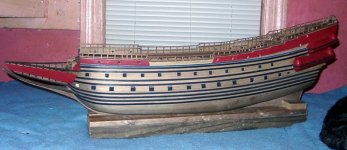

Im back to working on my Wasa once again I ran into a problem and setback with the bow area vertical bulwark supports.As I started to intall the upper caprail,they started to pop away from the bulwarks An obvious glue failure.Im throwing out the wood glue that I used and am buying a new supply.I reglued all of them with minute drops of Gorilla Glue.They are as strong as steel now. Second photo shows handrail in possition.The caprail and handrail setup is different from the Sregal kit plans..........Im atrás al funcionamiento en mi Wasa otra vez entré corriendo en un problema y el revés con el área de arco apoyos de baluarte verticales. Cuando comencé a intall caprail superior, ellos comenzaron a hacer reventar lejos de los baluartes un fracaso de pegamento obvio. El arrancamiento de Im del pegamento de madera que usé y compro un nuevo suministro. Pegué de nuevo todos ellos con gotas de minuto del Pegamento de Gorila. Ellos son tan fuertes como el acero ahora. La segunda foto muestra la barandilla en possition. El sistema de barandilla y caprail es diferente de los proyectos de equipo Sregal. Cheers Walter

Hello Guillermo,thanks. :D I have been working on the Wasa for about four years off and on.I was able to finish the waterways last evening working late into the early morning hours.Today I have started the hand rails.I have been researching them extensively trying to get them as close as possible to the real ship.I am using Gorilla glue for strength on the delicate parts like the hand rails. http://www.gorillaglue.com/glues/gorillaglue/index.aspx It takes around four hours to dry,so progress is slow :wink: Cheers friends Walter.........Hola Guillermo, gracias. : D I ha estado trabajando en el Wasa por cerca de cuatro años apagado y encendido. Podía acabar los canales la tarde pasada que trabajaba tarde en las horas de la madrugada. He encendido hoy los carriles de mano. Los he estado investigando que intentaban extensivamente conseguirlos tan cerca como sea posible a la nave verdadera. Estoy utilizando el pegamento del gorila para la fuerza en las partes delicadas como los carriles de mano. http://www.gorillaglue.com/glues/gorillaglue/index.aspx tarda alrededor cuatro horas para secarse, así que el progreso es lento: guiño: Anima a amigos Walter
