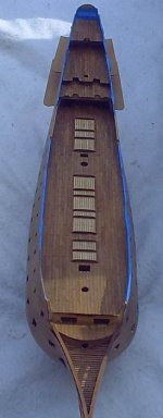

Hello,Thanks Guillermo!I have completed installing my deck planking.It is coated with coat of Sherwin Williams sanding sealer.I will now coat the decks with three coats of a graphite powder/urathane mixture.I will let it dry and scrape the decks leaving the graphite between the planks to simulate caulking,Walter...........Hola,Gracias Gurillermo!!! he completado la instalación de la cubierta de mi planking.It es cubierto con el escudo de Sherwin Williams lijado sealer.I ahora escudo los platos con tres capas de polvo de grafito / urathane mixture.I se déjelo secar y raspar los platos dejando el grafito Entre las planchas de calafateo para simular, Walter :D :D

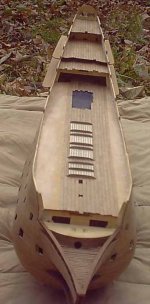

Thanks Guillermo!No not blue it will be red.The blue in the photos is painters tape.I did not want to keep taking it off for the photos.I have to still plank the inner sides of the bulwarks.So I do not want to get any varnish on them.Today I whittled down five pencils takeing out the pencil lead.l sanded it down into a fine graphite powder and mixed it with satin varnish.I applied three coats to each deck.Tomorrow I will scrape down the decks hopfully,with pleasant looking results.Cheers Walter PS I hope the photo is not too shocking :shock: it is VERY BLACK..............Gracias Guillermo!No azul no será red.The azul en las fotos es pintores tape.I no quería toma este medicamento fuera de la photos.I tienen que aún parqué el interior lados de la bulwarks.So no quiero llegar a ningún Barniz sobre ellos. Hoy me whittled cinco lápices takeing a cabo el lápiz lead.l lijar abajo en una multa de grafito en polvo y mezcladas con satinado varnish.I aplicarse tres capas a cada deck.Tomorrow voy a raspar las cubiertas hopfully, Con agradable busca results.Cheers Walter PS Espero que la foto no es demasiado sorprendente :shock: es MUY NEGRO

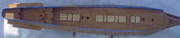

Hello,after a few hours of off and on scrapeing of the decks ,They have cleaned up nicely . I applied two coats of tung oil .Now I will plank the inner bulwarks Cheers,Walter..............Hola, después de unas horas de despegue y sobre scrapeing de la decks.They han limpiado nicely.I aplicó dos escudos de tung oil.Now me parqué el interior bulwarks.Cheers, Walter :D :D :D

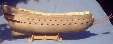

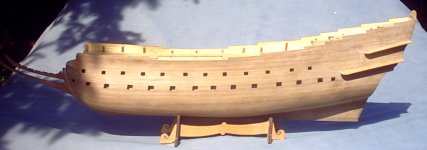

Muchas Gracias por sus amables palabras a mis amigos! Se ha pasado un tiempo desde mi última update.As la espera de un gran tormenta de invierno para llegar aquí, en Nueva Inglaterra, yo estaba en condiciones de tomar unas cuantas fotos antes de que la nieve ha empezado a fly.I han completado la mayoría de la parte superior de clinker planking junto con La caprails.I han empezado también a la popa marco donde la lanturn es located.I creo que voy a añadir ahora a los principales wales.Cheers de nevadas Norwich Connecticut, Walter................... Many Thanks for your kind words my friends! It has been awhile since my last update.As we wait for a major winter storm to arrive here in New England,I was able to take a few pictures before the snow has started to fly.I have completed the upper most clinker planking along with the caprails.I have also started to frame the stern where the lanturn is located.I think that I will now turn to adding the main wales.Cheers from snowy Norwich Connecticut,Walter
