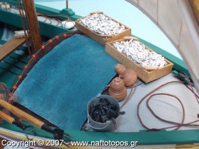

Hi to all. Allow me to show you my method on creating "fishes in case (box)” for fishing boat models.

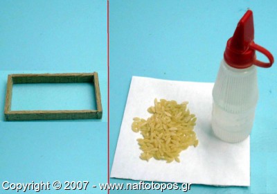

The materials that you will need are: Small pasta in your shape that you like…Invisible glue…a square shaped form in the dimensions of your “fishing box” with no bottom….and silver paint.

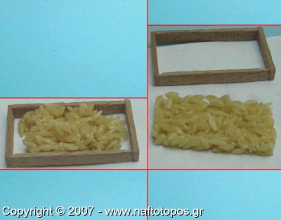

1. First you have to measure the pasta to fit it into the box…and then spread the glue on the measured pasta.

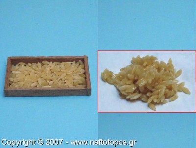

2. With the glue wet … put the pasta into the squared form on a piece of paper and spread it to the corners.
3. Wait for a while and before the glue be dry remove the form from the pasta and let the glue to dry.

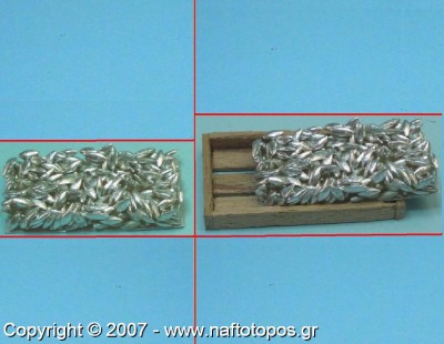

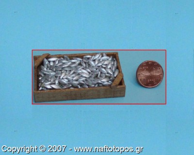

4. At the end you paint the pasta with silver colour and place it in the final “fishing box”.

Sorry I forgot to tell about the paint.
I used silver paint in spay…
